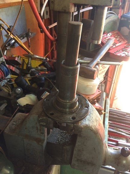

I recently had to repair two WWII Ford Jeep front drive components that had worn bushings fit into counterbores. The fact that the bearing ID was just a little smaller than the bore’s major diameter made it impossible to use a punch or bushing driver to remove them.
Photo 1

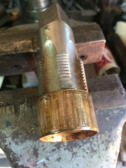

In these cases, or when bushings are installed in blind holes, I use a tapered pipe tap that roughly corresponds to the bushing inside diameter and install it using my lathe for alignment. I used about six turns of the 1” NPT tap shown in the photo.
Photo 2
The assembly was set up on my bench vise and I was able to drive the bushings out quite easily with moderate hits on a brass drift. A little heat from a MAPP torch helped.
