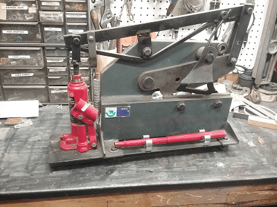

A second problem I had to overcome was due to my limited bench area; I could not secure the shear without a clamping arrangement.
Also, trying to hold the material to prevent it from moving while pulling on the handle proved to be difficult.
Photo 1
With a small bottle jack and some fabrication, I was able to do away with that cumbersome handle.
I can now set the shear anywhere and easily hold and cut the material.
